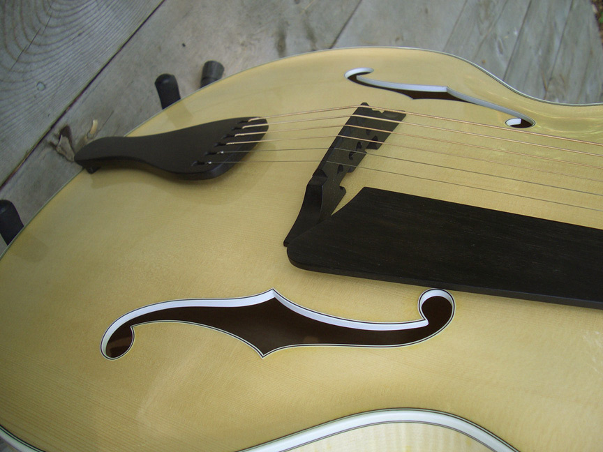

You are right -- you don't need anything to fill the pours of maple and as
always, Don is right on target by suggesting you will want to "warm up"
the color of the maple because the KTM9 is so clear. On this archtop I
started right from the first coat with KTM9 that was tinted with amber
colorant -- not too much. With each successive coat it got a little warmer
until I had the color I wanted. The remaining coats were clear. What I like
about this process is that nothing is clouding up or muddying up the
figure in the maple, even though it's hard to see in this pic. I also like it
because it's not complicated.
Craig
PostPosted: Wed Oct 12, 2005 11:54 pm
Craig, I'm always in awe of people that can bind f-holes like that!
PostPosted: Thu Oct 13, 2005 1:24 am
That is some very pretty work.
PostPosted: Thu Oct 13, 2005 1:29 am
Nicely constructed "archie" Craig. Even with the amber...it still looks pretty blonde! Also by just spraying tinted water based lacquer do you find that the figure has been "popped"?
PostPosted: Thu Oct 13, 2005 1:35 am
I've had the good fortune of playing that archtop...and it's sensational.
Anthony, waterbornes can not by nature pop the grain the way shellac or lacquer etc can. They sit on top, and don't reeally penetrate to give that "wet" look that pops the grain. They need a little help.

Don, you're right, the grain does need a little help to pop it. By using the
KTM alone I agree, it doesn't pop as much as it could. As you know, I just
sprayed my current effort this past weekend. I had used epoxy on this
one. The neck is flamed maple and my feeling is it makes the grain just a
little too contrasty. Have you found that and if so, how do you control it?
Anthony,
the side area you see has a fairly strong light hitting it, so it looks a little
lighter than it really is. But you could continue to spray tinted coats until
it was as dark as you wanted.
And thanks all for the complements. It's always with trepidation that I
would post a pic because all you folks have the bar kicked up so high.
Craig
